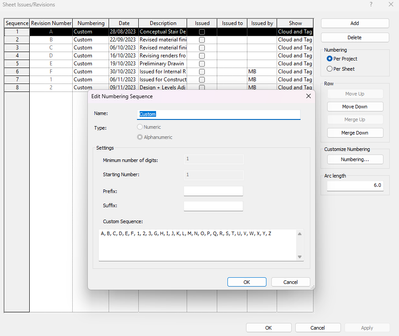

Hi All,
I need help with the following:
Why even though that the dates are newer, if I put numeric for the last 2, they are sent to the beginning? I would like to organize the revision by date, or at least have the letter first and the number after.
7 ANTWORTEN 7
Nachricht 2 von 8
Alfredo_Medina
als Antwort auf: designQACJB
Use the highlighted tools on this image, to do what you need:
Sort by Sequence or by Date.

als Antwort auf: Alfredo_Medina
Hi there,
Thanks for the reply, unfortunatly it doesnt work as I still cannot put the "numer revisions" AFTER the "letter revisions".
Any ideas how can I change that?
I want to have in the revision schedule, first the letter revision and after the number revisions.
Manually Move Up or Move Down
Nachricht 7 von 8
are you saying you want to sort revision table by date? If so, edit Titleblock and change the way the revisions are sorted (Sorting/Grouping Tab).
Nachricht 8 von 8
designQACJB
Thank you!!!! You are the man :grinsendes_Gesicht_mit_lächelnden_Augen:
