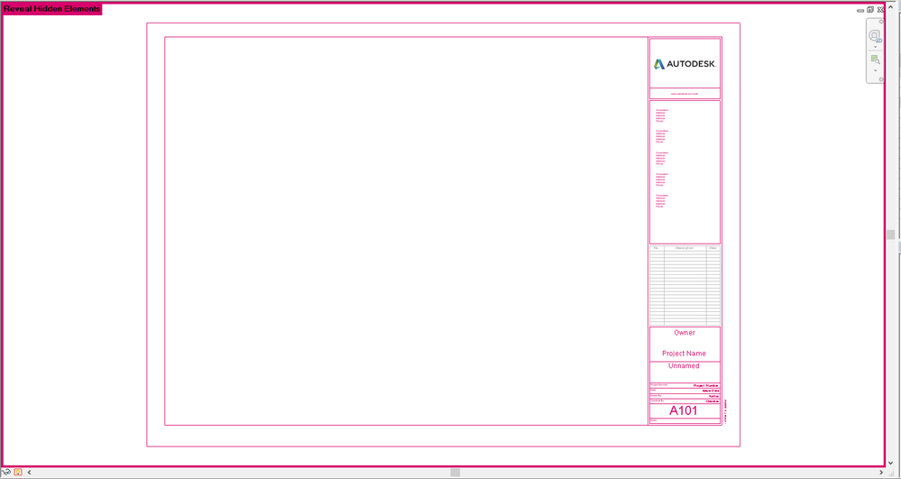

While working on a view placed on a sheet, we have been able to use Element Hide to hide items such as the sheet boarder. However, Reveal Hidden does not seem to work at all on the sheet. How do we get Reveal Hidden to work so we can then use Element Unhide? See attached screenshot.

Not sure if I understand you entirely, but Reveal Hidden elements only reveals what belongs to the current workspace.  SO, if you hide something on a Sheet, you have to reveal them when you are on a Sheet, not in a View placed on the Sheet.  And vice versa.
Below is a hidden sheet border can be revealed just like everything else using Reveal Hidden elements tool.

I figured out how to get the hidden elements revealed. I clicked on the light bulb button at the bottom left of the screen and my hidden elements showed up. I created a post yesterday because I was trying to use the keyboard shortcut to do that and it didn't work. Attached the screenshot of the same. I now see that you had the same button activated in your screenshot. Again my issue appears to be with the keyboard shortcut not working. Any suggestions on how to get the keyboard shortcut to work will greatly help.
