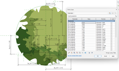

I have a Planting family with a parameter "Canopy Width" that works independently of "Height". I can enter a Height and Canopy Width, and the family will produce an elipsoid of those dimensions. The plant detail in plan also resizes with Canopy Width, independently of Height, using this formula: Invert Width = (0.001m2 * Height) / (Canopy Width / 2mm).
The plant family is organised as follows:
PLANT
->PLANT CHILD (with elipsoid)
-->PLANT CHILD DETAIL 1 (basic circle - working)
-->PLANT CHILD DETAIL 2 (autocad plant graphic - not working)
The question is, how to I apply this Invert Width to anything other than individual lines/circles, so that I can resize an elaborate set of detail lines as a group? It seems that I would need to constrain all lines to each other and to a master radius, which is not an option.
The image below shows how the palm is not resizing with the elipsoil in upper left window.
Any advice appreciated.

Is this enough for you to figure out?

I would add the detail group family into a new model family. Set the detail family to scale with the planting family. Then you add that new family into your planting family. Afterward just scale with the family. Here is an example you can use.

Thanks for the reply, but that is exactly what I don't want to do.

I download that from Revitcity and embedded into generic model family. Don't bother with the detail parameter just embedded your detail into that family and remove the sample detail family.

That looks promising but it appears that scale factor cannot be set by parent families?
Scale factor parameter doesn't work in project (autodesk.com)

Load the CAD import into the family and then you can scale accordingly with the planting family that I've attached.

Thanks but that scales diameter with the built-in Height parameter. My family uses a separate Width parameter to set the Canopy.
The intention is to use the ellipsoid to cast more accurate shadows instead of the usual shadow-in-detail-family or elevate-from-work-plane. It can be useful when I'm not preparing a separate 3D concept.

I would simply add detail to fine or course. Fine would display the detail tree and course for ellipse 3d tree.

Not clear on what you are wanting to do, but it almost sounds like you are wanting a scalable family.
 Scalable Family in Revit - Revit Family Tutorial - Bing video

Luck?  I don't count on it.  See attached.

Figure of speech. Thanks, though. It works.
