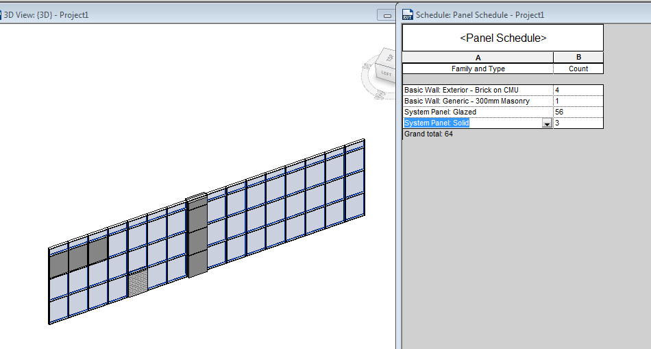

How do I reset all the overriden curtain panels to what is default under Curtain Wall type definitions?
11 REPLIES 11
Message 2 of 12
I doubt that once unpined the panels in order to change there type , we can reset the overriden panels.
Anyway a workaround to make this process a quick one, could be by creating a simple Panel Schedule consisting in two Fields: Family and Type and Counts with Itemize Every Instance unchecked and from here to change the Family and TypeImage 1.png

I have tried that too but unless I am missing something, it does not work when you have multiple Curtain Wall types.
For example: I have 2 Curtain Wall types: Fence CW & Gate CW, Fence is set to use Panel & Gate is set to use Door. Some Fence CW Panels are unpinned and changed to Doors. I want to change them to the Gate CW.
This a very simplified example and I have more like 16 CW types with that many Panel types.

I realized I wasn't clear. Here goes:
I have 2 Curtain Wall types: Fence CW & Gate CW, Fence CW is set to use Chainlink Fabric as its panel; Gate CW is set to use Chainlink Door as its panel. Some Fence CW's Chainlink Fabrics were unpinned and changed to Chainlink Doors. I want to reset them back to Chainlink Fabrics just as when they were initially drawn without manually pick one by one.
I have thought of the schedule approach but Curtain Panel schedule can't show the Curtain Wall's fields (host) so I am not able to filter based on Curtain Wall types.

I'm not sure that can solve the problem in the way you want it, but a sort of joint venture between a Door Shedule and Panel Schedule  could work ...something like in my screencast...

Thanks for making the screencast. I understand your approach.
The problem is that some of the CW doors are properly placed in the GateCWs, and some are incorrectly overridden in the FenceCWs. Selecting them via a schedule would highlight every instance, including the ones in GateCWs which I wish not to change.

I have not tried the following... it is only a guess...
Select, by drawing a selection box, the entire collection of elements that make up the wall. Filter the selection, unchecking mullions, curtain walls, or whaterer else you've grabbed, leaving only panels. Unpin them all at once using the ribbon tool. Use the type selector at the top of your properties window to set them to the fence option. Re-pin them all using the ribbon tool.

Your post has inspired me to do a test and it turned out to be quite simple. I just need to select all the curtain panels in the projects, whether via selection filter, schedule, or family browser, and pin them down. That will reset everything to default curtain panel type defined in each curtain wall type.
