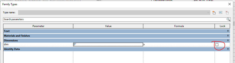

Hello!
Is there any way to lock a parameter so that when eg. a room description is changed it automatically resets to default (nothing)?
Or is it possible to lock a parameter so that no one else can change it?

No. But they can be done via a project manual or a bim execution plan.

It is possible to lock a parameter - check this box -
Capture.PNGOR type in the desired value under Formula - in this case, the dimension will stay locked at 60"
Capture.PNGOR
Control the values in multiple families using Global Parameters

No, that "Lock" does not lock the value of a parameter.
What the user wants to do is not possible. An approximation would be to set the value of a parameter equal to a formula, but the user can open the family and modify that, too.

"Or is it possible to lock a parameter so that no one else can change it? "
for this, that parameter should be Type Parameter with actual value given and locked..
one more level up, one can have another type parameter connected to the original one..
Ex
height = Height A
Height A = 700mm and ( Locked ) ( type parameter )
this way, first parameter cannot be changed that easily...
Best way is just to have a parameter name suggesting its a FIXED Value
ex: FIXED HEIGHT = 700mm.... and family name suggesting the same..

For system families (rooms, areas, walls, etc...) you cannot quite reset a parameter when another parameter changed, but you can use a key schedule to standardize the parameters values. For example, when you change a bedroom to a toilet, it automatically changes the finishes as defined by the key schedule.
For loadable families, you can follow other advices already been said. One can be better than another depends on different practices and workflows.
