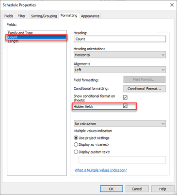

Trying to get a total volume of a category in a zone. I can get it but it showing the individual items. I want all these individual items grouped under the zone and showing me the total.
Just tried adding a count which seems to have resolved. Anyway of having this without a count ?

Can you make it a hidden filed in the schedule?

Thanks @loboarch that resolved
