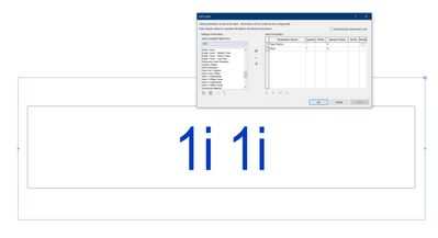

Finally created a solution for this! We show both existing and new steel on many plans, and we used to have to model it by phase, and then go back and have 2 different tags for it. I decided I needed it to work with just one tag. This solution simply requires you to run the dynamo regularly.
I hope this helps all the other designers out there with the same problem!!
I'm posting this here and on the Dynamo forum. It's a big help for us.
With a combination of Dynamo and creating a custom tag family for beams and columns I was able to use one tag to mark both existing beams/cols(E) and new beams/columns. A real game changing for us. I will be happy to give any help on recreating this.
My first post so hopefully I do it correctly.
The dynamo code looks at the phase and if it’s existing it adds “(E)” to the value “Mark” on the member.
The tag then reads this value.
Of course, you can use any parameter of the member that is not in use. We weren’t using the “Mark” parameter.
