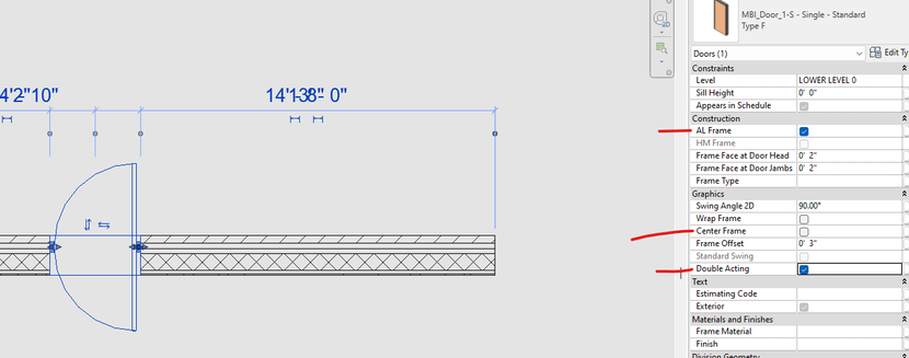

Try replacing the Family Parameters with Shared Parameters in the family (update it in your family, then reload it into the project and the Detail Library file).
See the following screen shots to demonstrate the difference between Family Parameter and Shared Parameter behavior:
Here I insert a door Family with a given type of door and the three marked lines are the defaults for both this family and the one that I will be changing this one to.
Here I change the defaults:
Here I change the door to a different Family and type:
You will note that the shared Parameters "AL Frame" and "Double Acting" keep the values when switching door types (and those values are not the default for either Family/Type) while the Family Parameter "Center Frame" changes to the default defined in the type.

"not ones already placed"
Very true.
In the case that the OP presented however, changing the parameters to shared in the family in the detail library file, then changing the parameter to the same shared parameter in the family in the project file (better, of course, to load the same detail item family into both documents), then importing the details from the library file would create a situation where the imported detail items are "new" in the context of the project file IE: being placed "afterward".
This was the intent of my suggestion, to address the situation in the future.
