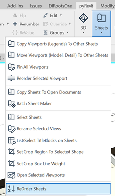

You can use pyRevit ReOrder Sheets tool.

@syman2000 I'm not sure the sort order parameter will work unless I re-number all sheets by the sort order & change the sorting/grouping. Attached is an image shot of all the sheets in the project but my goal is to reorder only the solar sheets. I've never used pyRevit, @ToanDN , do you think it will work for what I'm trying to do?
Why would I suggest something that I think will not work?
