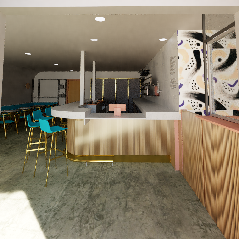

Hello.  At some point, my model went all wonky and when I tried to render, none of the materials would show up. Everything is rendering in a generic pink material. The top pic is original. The bottom pic is what's happening now.
Not sure what's going on. any help would be appreciated!

Check and see if your phase filter is set to complete. If it is set to other phase, it maybe overridden with one material texture

You're my hero.  I can't believe it was that easy. Thank you!
