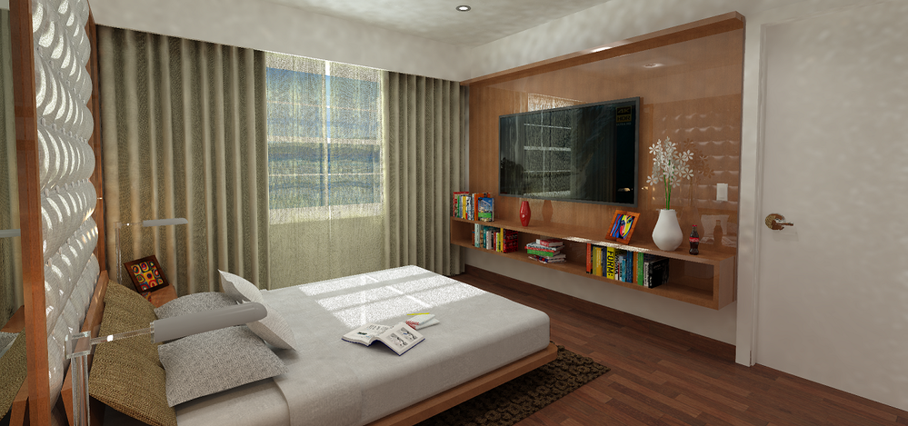

I'm using revit 2019 have some rendering issues 1. In master bedroom render the commode is highly reflective like glass..I can't seem to fix it 2. The light outside (left side of the pic window) is to bright...can that be fixed? 3. Kitchen - I have a oak floor but I get these strange circular reflections? 4. on 3dview 14 the floor is in different colors?..almost as something is overlayed? The commode has a material assigned to it. any help is greatly appreciated

As I can see in your family there are two parameters that are involved in this:
  • Glosiness
  • and Reflectivity
they have to be decreased

...and, try to use a wood default setting as in my screenshot.
Make your material using as base a wood material from material library and make a duplicate that has your settings.
There you can control the wood finish aspect.

you are using a Semi Gloss Varnish . Try Unfinished or Satin Varnish

aRcHiTeCt.JM
… this is in part because you are rendering in DRAFT mode.
… you need to render it at least in HIGH or BEST to get a better more real result
  1. The light outside (left side of the pic window) is to bright...can that be fixed?
…. Off course you can fix it
… click your light and edit the properties ... of the light
..... or if "the light" is the SUN
.... you can change the hour, day, position to get to the desire effect
  1. Kitchen - I have a oak floor but I get these strange circular reflections?
… again… is because you are rendering in the wrong setting (draft instead of high or best)
  1. on 3dview 14 the floor is in different colors?..almost as something is overlayed? The commode has a material assigned to it.
…. Can you apload the .rvt to take a look ?
.... when rendering in DRAFT your materials get shinier
... take a look at this sample in DRAFT

Constantin - thx - I got the dresser resolved.
