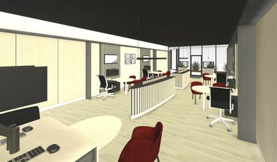

We have been experiencing issues where Revit begins to glitch. We have been trying to do some system upgrades and see if any of this can fix the issue and so far no luck.
Finding that batch exports of images or pdfs result in funny glitches as per the attached images. However this isnt just happening when exporting, it will happen within the program itself, where renders will begin to glitch and you will find families missing in one view but not others. This will happen in realistic views, hidden line etc etc.
Any ideas?

have you try to install latest updates from autodesk? intall latest updates of your graphics card driver and try to untick use hardware acceleration from options and see if helps.

All latest updates are done. I'll investigate the other two options and see if it makes a difference. Thanks for your response!
Any and all other ideas are still welcome!

What kind of graphics card are you using?

Graphics card: Nvidia RTX A2000, with 32GB RAM + 12GB RAM dedicated to the graphics card
