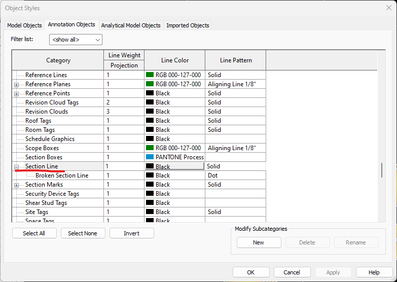

Thank you for your response. How can I change the style of the connecting line? Because I did not find any family related to this line.

RSomppi
als Antwort auf: mahan_motamedi-1991
Nachricht 7 von 7
@mahan_motamedi-1991 wrote:
Thank you very much for the response. It seems a good solution for small projects. But is there anyway to define in as a style so I won't need to adjust each section manually?
Best,
It's not a style. It's a property.  Now if you want to use a gapped one that you created in another View, you can Clipboard Copy/Paste it between Views.
