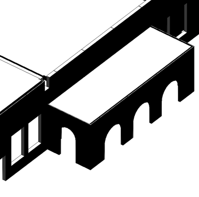

I have problem with Realistic view, this is how it looks now.
Any clue? Thanks.
in shaded mode, this how it looks.

First check materials of your walls. Than also check lighting, shadows and exposure of the view.

If you have Phases, set the View to "Show Complete".

I don't see anything unusual.  Where's your Sun?  Turn on the Sun Path to find out.  Move the Sun to correct the Lighting/Shadowing.
