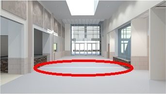

I am changing a camera view to Ray Trace and the  tile floor is only showing a strip of tile and the rest  is black.
any clues?

when I view the same view in realistic, its fine.

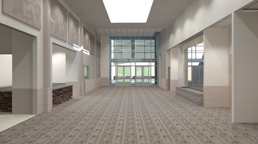

ray trace                                                                       realistic
Nachricht 7 von 10
als Antwort auf: htews
Yep, I see a big red circle in one, but not the other.  Cool.
Seriously though, what are you trying to show me with this comparison.  I can't tell much because of their postage stamp sizes.

in the ray trace, the strip of floor (within the red) going across is not being tiled unlike the realistic version.
Actually, within the floor, the material was tiling horizontally but not vertically.
still need to adjust the glazing.  sorry, this is my first "realistic rendering" using Revit.
