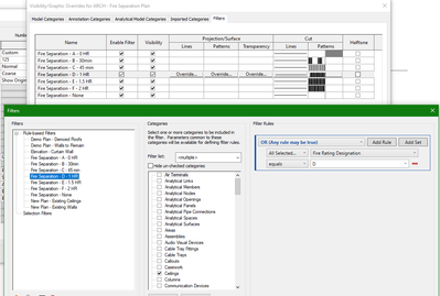

We normally use graphic line over wall center for this purpose, but the line won't move as the wall moves (locking it seems more work unnecessary).
I use pyRevit to make filled region pattern ok on plan, same size. But ít won't apply to graphic override. Perhaps i missed steps somewhere.
Anyone ?

Coarse scale pattern for coarse and cut pattern for medium/fine.
Nachricht 3 von 14
Mike.FORM
als Antwort auf: yes_and_no
We use a key schedule to set our fire ratings for individual walls.
Then for our Fire Separation plans and building sections we have a filter that reads the Fire Rating Designation Value and applies a specific cut pattern override.

If the Rated value is a parameter value in the wall, then use viewfilters to override the appearance.
"I use pyRevit to make filled region pattern ok on plan, same size. But ít won't apply to graphic override"
What doesn't apply to graphics override?

"Using graphic/symbolic lines are "not Rv way" ... Don't know who says that, but using graphics overrides IS a 'Rv way'
Maybe in terms of BIM using detail lines and not giving the 3D elements that data or keeping that in sync, Yes I can relate to that.
"As in (2) the wall currently can take solid shaded red color, I wonder why can't ít take a patterned dash."
So with a Graphics override with color + 'dashed' pattern the wall doesn't get the pattern?
- Is Cut Pattern overridden? + is wall cut (I assume floorplan)
- Maybe the dashed pattern is to dense, check other viewscales
- View set to Detail level Coarse, maybe it overrides with the Wall's Coarse pattern? (Not sure if a ViewFilter would override it) anyway, set the view to Medium or fine. (or else just the wall category in the view/template)

To make a fire tape pattern work with filter, edit the pattern and make sure it is set to orient with element, not view.

Per yr advice I successfully made the rated pattern appears in plan, including in PDF print.
One step up, how do I do this as a filter, without making separate wall type ?

We use a key plan so that we get a drop down parameter in our wall properties that we can use to set several parameters. We then check our Fire Rating Designation parameter with several filters to set the correct cut pattern to walls, floors, ceiling and roofs. The Fire Rating Designation is a letter value and we also show this in our standard wall tags.

If you don't want to create Type per Rating, use a instance parameter.
I see @Mike.FORM post uses a key schedule to populate the instance parameters, if the rating includes more than one value use that as solution.
