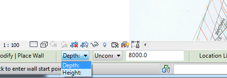

Good afternoon. I'm using REVIT 2015 and using a very old architectural drawing (TIF file) to build a new model from. However, when I insert the file it covers up any walls etc that I put in. Is there some way to set the transparency of the image? (I've tried moving it the back and that doesn't seem to do anything).

if Rodrigo's answer doesn't help, then try to increase the View Range of the View both in Bottom and View Depth.
Maybe , when you have drawn your walls you've used Depth instead of Height....

I've checked and the walls were all done using Height.

Found the issue. In my floor plan properties I had discipline set to electrical instead of architectural. Once I changed it to architectural everything worked fine.
