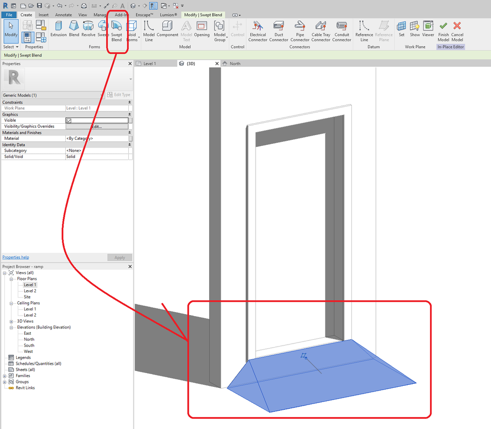

... you can create it as a MODEL IN-PLACE family
.... you need to use sweep blend and draw the requiered shape
aRcHiTeCt.JM
REVIT EXPERT ELITE
➪ ➪ ➪ ➪ ➪ ➪ ➪ ➪ ➪ ➪ ➪ ➪ ➪ ➪ ➪ ➪ ➪ ➪ ➪ ➪ ➪ ➪ is it working for you ? ➪ ⇩ 'Accept as solution' ⇩ ⇦
Nachricht 6 von 54
Avaris.
als Antwort auf: aRcHiTeCt.JM
Cheater :leicht_lächelndes_Gesicht:
Then I would recommend to draw a litte rectangle in both sweeps below the reference line ánd create a void to cut off the material you don't need. Nonetheless, clever solution!
Nachricht 7 von 54
Hello is there anyway you can show me in screencast tutorial on how to do the ramp with 2 siding on both sides as shown in my screenshot above so I can try to put parameter in massing. If can, If cannot its fine with me. Thank you
Nachricht 8 von 54
aRcHiTeCt.JM
als Antwort auf: Anonymous
... hi @Anonymous
... go to level 1
... component
... model in place
.... choose generic model (or the one you need / want
.... click OK
.... rename it
... click ok
..... choose SWEPT BLEND
.... first ....Sketch path
... click ok
.... start the line on the top part to know where will be the first profile
... click ok
....go to the north elevation
... select profile 1
... and draw it the way you want
.... after finish click OK
.... now repeat the profile process for the second one
.... draw a thin rectangle
... click OK
.... now click OK... and finish your family
.... go to your 3dview
... done
