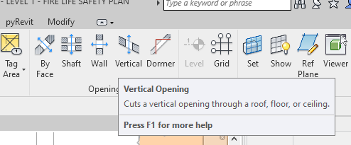

als Antwort auf: aolivieriPPG7E
These tools should be considered before anything else.  They literally say what they are for if you bother to read the tooltips.
