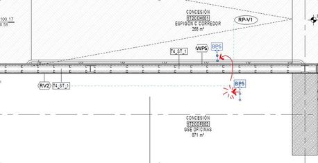

I have some problems with the position of a railings tag once I sync my local file, them lose the right position. This is the context:
- I'm working local file exclusive for Sheets where there is a Revit Link, that contains several railing of stairs. Once I open the file or Sync, the railings loose its position. Just in case, the raillings wasn't touch by nobody
Wrong position when I open the Local File
Then I move it few milimeters., automatically moves to a position close to the correct one.
Can anyone help?

@ToanDN  You are rigth. I forgot to replicate the shared position of both files. In the project i'm working on, in fact we have a URS file where all link are positioned (Models and Sheets files). I reattach the files, and the positition should be "Position A".
Coord File: Contains the Grid and it's used to positioning and record the position.
@Sahay_R I think, with the shared position, shows the tag issue.
Regards!

I don't know what caused it to happen but you can try to select all the railing tags and use the keyboard's arrow key to nudge them back and forth.  I think they will snap back to the host.
Nachricht 8 von 15
als Antwort auf: ToanDN
Thank @ToanDN. It solve at least the practical issue about its position. But I want to know why it happens, otherwise we must keep reviewing all the sheets over and over again.

You can try "Audit" to the Family Railing Tag. It worked for me.
Regards
Nachricht 15 von 15
carlose.jaimes
als Antwort auf: Anonymous
If the above procedure doesn't fix them, I also recommend you check the version of Revit and install updates. All collaborators must use the same version. For example, I used the 2018 version, now I had to switch to 2018.2 on all computers. It works
