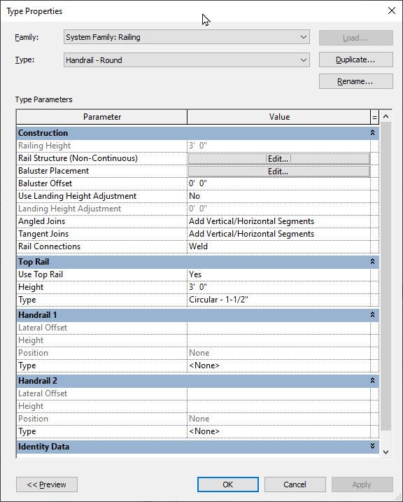

Attempting to work with railings on stairs and not fully understanding the extension of the top of the railing system.  At the top of the steps, ideally the railing system (post, balusters, top railing, bottom railing) would extend/complete to the wall at the top level.  But that appears to either not be an option or not working for me.

I feel the issue should be somewhere in the "Edit Baluster Placement" dialog box, but have tried to adjust several of these and none appear to correctly place the balusters continues up to the wall.

Not for sure this is you wanted, try to edit the path of railing and extend to the wall. It will grab the system, post, top/bottom to the wall.
