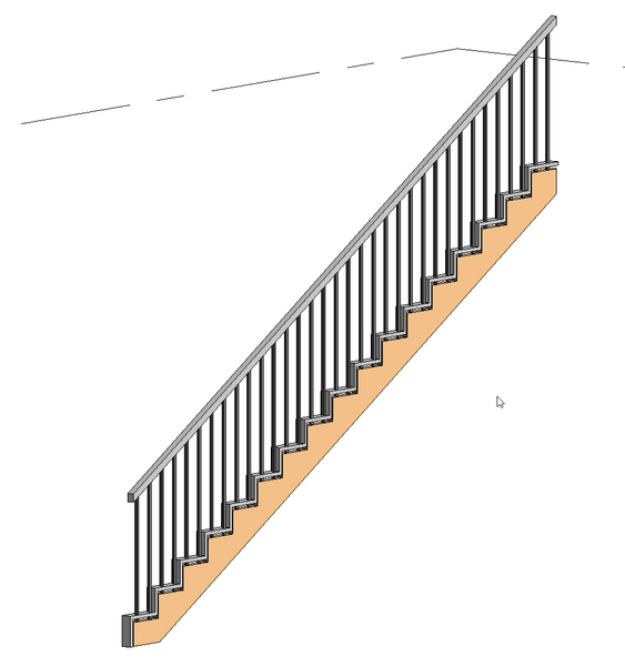

Hi, I'm looking to get the lower rail of a railing to follow the steps of a stair (see attachment).
In the image, I have modelled the bottom rail as just a Generic Model sweep that is separate to the railing, but ideally I'd like it to be integrated.
Can anyone offer any solutions?

Thanks for the response, I understand Top Rails, but this does not give me the result I'm after.
I want to avoid having to manually model this rail for every staircase.

That is how I created the lower rail in my example.
Ideally I want to avoid having to model this on every core staircase in my building (multiple cores over multiple floors!)

It can simply be modeled into the Baluster family...
- extrude as many posts you need per thread
- extrude the base plate
- in the project set 1 baluster per step

Thanks, this is what I'm after!
Never thought about integrating it into the baluster, looks like I've got a bit of work to do!
