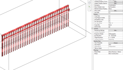

Are Railing Supports not supported by Phasing?
I'm working on a remodel, and there are existing wood fences at the property boundary. I've created a railing family with square posts as Handrail Supports. The vertical boards are Posts in Baluster pattern. The fence posts as Handrail Supports allows not having to break the Path Line every place I want a fence post.
When I change the Phase of the Railing to Existing, with Graphic Overrides in the Phasing, the Handrail Supports NO NOT graphically show the overrides.
The Phasing Graphic Overrides shown below have Existing as Dashed Magenta lines. The fence posts as Handrail Supports are displaying this override. I cannot find any other control for the Handrail Supports. Am I missing something???!!! TIA. mpp

Good idea. It works. It can also be done in VG Overrides in a view or view template. It's unnecessary work, and another needless work-around.

There is another way.
Nachricht 8 von 11
mpukas
als Antwort auf: mpukas
@ToanDN I don't follow what you're suggesting?
This is what I've done and what I get...

Can you open the file attached?

Yes, I opened your file. I'm still not sure what/how you did...

I created Assembly from handrail supports and changed the Phasing for the Assembly.  But I would go with using a filter with Phasing criteria in a view template myself.
