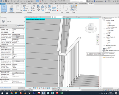

Hello I have this problem with this railing. Is it possible Revit makes it well? Thanks

Use a Landing Height Adjustment and Connector.
It's going to require some finessing...

But, how do i know those values? Thanks
Message 5 of 26
Finesse it. Play around with values until it looks right.  Or, if you are so inclined, use Ref. Planes in Elevation/Section View to find the exact perpendicular distance to the intersections of the slopes.
Message 6 of 26
You put another segment. Is not possible to move the end of the flat part?
Message 7 of 26
All I did was add a Landing Height Adjustment and Connector as shown in screenshot. Revit did the rest of the work.

Edit Sketch and extend lines here:

Here, I did some cleanup by modifying the Rail Joins on the Top Rail. Do you know how to access those tools?

OK, to be fair, just by applying the railing connectors and a landing height adjustment, my railing did not look as smooth as @barthbradley railing in his image. Was there something extra you might have done @barthbradley that you may not have thought about?
If i add those connectors and then edit the railing sketch, i get a slightly cleaner result:
@Anonymous have you tried both of these options together? It isn't perfect yet, but this situation is not always easy on any stairs.
@barthbradley in the 9th message, you have a nice smooth transition from the upper rail and i can see the split line where you have edited the rail path, but i cannot get the same results you have. perhaps a screencast video of what you did would help?
i can edit the path to add segments, but not remove some. i've tried to adjust the railing sketch path in a variety of ways, as well as match the other railing properties you have shown. i don't think this is as simple as you imply.
my attempt:
