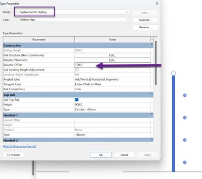

HI I CREATED A SPHERE BALUSTER FAMLY AS SHOWN IN THE IMAGE AND ADDED IT TO PROJECT WITH RAILING.
THE PROBLEM I AM FACING IS THE RAIL CENTER NOT SAME AS BALUSTER CENTER AS SHOWN BELOW
I TRIED WITH CUSTOM PROFILE AS WELL AS THE REVIT DEFAULT PROFILES
APPRECIATE IF SOMEONE HELPS REAGRDING THIS ISSUE

hi this is the rail edit options & height
This is the baluster placement options. Both rail origin & baluster origin not matching the same place
Please help

Check the Baluster Offset in Railing type.

hi thanks for the reply I checked the edit type property. There is no offset value provided

I didn't understand your problem correctly. I thought you were referring to some displacement in plan view.
From what I understand, however, you are referring to an elevation or a section.
Revit places the Ref. Level of the baluster at the top of the rail.
In the baluster family you can place a Reference Plane bellow the Ref. Level controlling the offset with a type parameter. Design the sphere with Work Plane the Reference Plane.
You can control the baluster height from this parameter.
