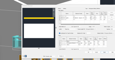

"Top reference is below Bottom reference for one or more Balusters. These Balusters are not created."

Why am I getting the error "Top reference is below Bottom reference for one or more Balusters. These Balusters are not created."? It refers to 'Balaústre Regular' as when I set it to none nothing happens. It also doesn't seem to show up no matter how much I play with the settings. I want it to sit between the base rail (the tall wall with 750mm of height ) and the top rail (starts at 1000mm of height).

the error basically means that the base and base offset settings for the baluster/post cannot be above top and top offset.

Change Top Offset from 0'-0" to a positive length value , such as the height of the Railing Baluster (e.g. 3'-0").  Or change the Top to Top Rail if you have one and leave Top Offset at zero.
