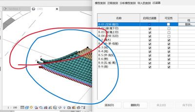

About linked project, I have 2 questions:
(1) how to accociate parameters between linked project with host project
 (2) the linked project has its internal visibility filters, I turn some off when inside linked project
But in the host project, all of these sub-internal filter all turn on, how can I turn some off in the host environment?)

2. Set the link display to By linked View and choose a view in the link that displays properly.
