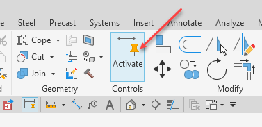

It's not gone, it's just always active so there is no need for a button. Thank God! Finally! So many trips to that button and clicks on it.

The concept isn't gone it's just reworked. Toggle on Activate Controls & Dimensions.
Did you even try it out?
This.  There is no need to find that button anymore.  I am not sure what the OP is missing.

Yeah, it's unbelievable that that button was added to the UI and NOT made it active by default....
How's is a user supposed to know that in 2023 you need to go there and make sure the new button is active?
I wasted 2 weeks drafting detail lines because I thought "Activate Dimension" was broken.
