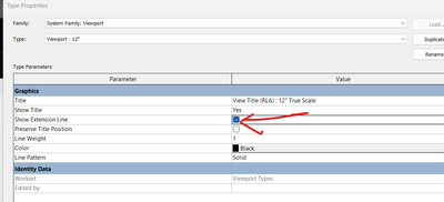

Select the viewport, edit type:
Nachricht 5 von 21
alexisCTZENP
als Antwort auf: ToanDN
also is checked. I'm wondering if there is some kind of internal setting we are unaware of... would you have suggestions on how to investigate this or know how to create a family with it as an option?

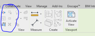

Click on it and check the pin/unpin tools under the modify tab. Or if it is pinned, a pin should show up toward the middle of the viewport.
Nachricht 12 von 21
alexisCTZENP
als Antwort auf: mhiserZFHXS
that's actually greyed out. would there be a  setting within my company or in revit that would make it so that's not an option to change?
Nachricht 13 von 21
mhiserZFHXS
als Antwort auf: alexisCTZENP
Which one is grayed out? Pin and unpin are two separate tools. If the pin tool is grayed out, that means the item is pinned, so hit the unpin button above it.
Nachricht 14 von 21
alexisCTZENP
both/all
