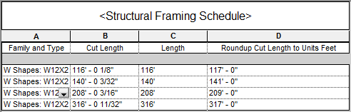

I need to find a way to round the lengths of these I-Joists tot he nearest, even, whole number. I am working on doing some Joist layouts and I would like to be able to pull the schedule right to the Sheet and print the quantities, lengths, and families without having to build a spreadsheet by hand. Is there a way to enter a formula that can round these lengths up to the lengths that my yard carries?

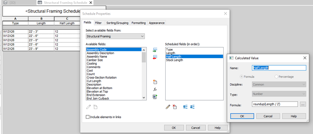

a calculated parameter using "roundup" or "rounddown", or just change the reported unit's accuracy for the field.

I'm looking to get the lengths to round up to even whole numbers. I.e. we carry joists in 10', 12', 14', 16', etc... lengths. In this picture I would ship out 32' joists instead of 31' 8" joists. Those fractions aren't anything to do with length. 10/32' = 10 joists/at 32 feet a piece. It is just a guide for the framer that will get this layout.

...or like this?

See below:
Message 9 of 10
Per usual @ToanDN, you never cease to amaze me. That worked perfectly. Thank you greatly!
