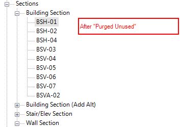

I recently ran into a situation using the purge command.  On a weekly basis to maintain file size, I typically will re-write my shared file (central file) barring anyone is in the project, run an audit, and purge the file.  When I purge, I generally will click the "check all" button.  I will purge until I see the number of elements check is 0 (zero).  This usually takes 2-3 times.
My understanding that if an element/component is loaded but not used, then it will be purged.   During this process of purging, some Building Sections and related Wall Sections somehow got purged from the project.  Initially we thought that a team member was deleting views by mishap.  I took the latest local file which was from the night before since I did all this the following morning, therefore not loosing any work or wanting to roll back to an earlier version not knowing when those views were missing from the central file.  I began testing to see if it was an audit issue, not thinking that it would be an issue with the purge command.  Once the purge command was initiated, and having my building sections expanded to see all building section views, I saw them disappear.  I called my Autodesk Product reseller, stumped them with this issue.  I tried this on another workstation thinking perhaps it was my workstation - not even, same thing happened on another workstation.
This is a concern with me as well as my firm and think it should be a concern with Autodesk in resolving this issue.  To maintain file size on very large projects such as the one I am currently working on a purge is necessary from time to time.

I hope this helps . . .
I have included three screenshots, my Project Browser is organized in such a manner that my section types are grouped together, so with some of the Building Sections that are getting purged even when they are on sheets, I am stumped. Hmm, did a search "Purge Unused" from Autodesk Revit 2016 Help . . . in the documentation the first line reads:
"Remove unused views, families, and other objects from the project to improve performance and reduce file size."
To me "unused" is the keyword, in which the views (Building Sections) are used and placed on a sheet, should not get purged even if the check boxes are checked.
I feel I have gotten a lot of feedback that discourages purge unused.  I don't feel that "purging unused" on a weekly basis is truly a bad thing.
This is the first time that I have ever experienced views that are "used" are deleted from the project browser as well as the sheet that the view is on.

no, this is odd behaviour - regardless of whether the views are on sheets or not Revit shouldn't remove them when purging as it is effectively purging something that by definitions isn't unused.
The section types that you are able to select should be ones that don't have any actual views attached to them - i.e. that type of section isn't used anywhere in the project.  If it is used then it shouldn't show up to be selected in the purge unused command.
can you confirm what section type(s) it is that is being deleted - is it all of one type or a random selection?
