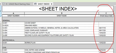

if i understand correctly... your trying to do something like this? showing the Issue date for each sheet?
