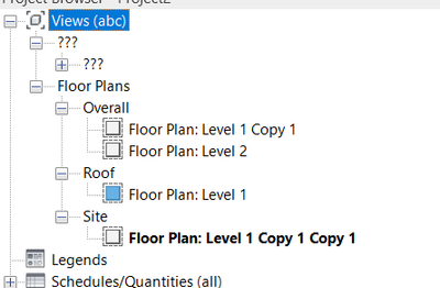

I need to have subcategories under floor plans.
Floor Plans
->Overall
----->Level 1
----->Level 2
->Roof Plan
----->Roof Level 1
----->Roof Level 2
->Site
----->Site Plan Arch
----->Site Plan Access
Right now I've got floor plans ---> floor plan and I can't figure out how to make a new category.

Sure thing.  Edit View Type and duplicate to create new types.
Browser Organization?  Create a Project Parameter for use in Sorting/Grouping.  Assign the PP to Views.
Something like this?
if so, 2 Project Parameters are needed for Sorting/Grouping.
