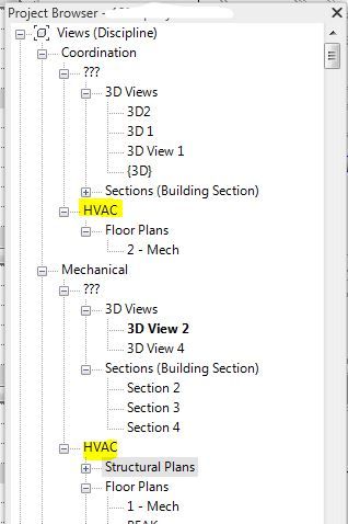

I created an HVAC drawing using the Mechanical template. The 1st and 2nd Mech Plans are under different categories in the Project Browser, and HVAC is listed twice. Can someone please point me to a video or tutorial that covers the basics of how this browser organization is supposed to work and so I can correct whatever i am doing wrong? I'm using Revi 2021 and this is only for coordination - not for a full blown engineering model.

You have your Navigation Project Browser organized by Disipline and by type (or something like that) and you have the views with the same type, duplicated with different category. You must change the 2 - Mech view to Mechanical Discipline.
You can see that organization with right click on the Views (Discipline) name.

  • Coordination & Mechanical are Disciplines (Built-in Parameter)
  • HVAC is a Sub-discipline (Project Parameter - Views/Project Browser sorting)
When you sort by Discipline, the sorting is Done by Discipline / By Sub-discipline / Family-Type...in your case
Floor plan 1-Mech is set to Discipline: Mechanical -  Sub-discipline : HVAC  - Family & type: Floor Plan
Floor plan 2-Mech is set to Discipline: Coordination -  Sub-discipline : HVAC - Family & type: Floor Plan
To list all under the same tree branch:
  1. EITHER Select or open floor plan 1-Mech and set it to Coordination (If as stated in the OP all are coordination)
  2. OR Select/Open floor plan 2-Mech and set it to Mechanical (if all need to be Mechanical)

Thank you folks for your comments, that worked for the plans, but I absolutely need to study this more as I really don't understand how the browser is groupie and sorting.
