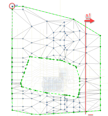

Hi, I’m encountering a problem when trying to edit Toposolid points in a section view in Revit 2024. When I open a section view and attempt to select a point, all points in the view are selectable, including those in the back view. This makes it difficult to select the points closer to the section precisely. Is there a solution for this? I didn’t experience this issue in Revit 2023

Maybe I'm misreading you. Are you saying that you can't select just one single point in Modify Sub-Elements Edit Mode?
Nachricht 4 von 6
No, i mean. when im Modify Sub-Elements Edit Mode topo solid, in a section view, i can see all points, but in revit 2023 you only see points closer to section view or infront not in back like now in topo solid
Nachricht 5 von 6
Yah, I get what you are saying. Modify Sub-Elements doesn't respect the Section view extents. All points are visible. It's no different in past versions though.  Test it. Modify Sub-Elements of a Floor in 2023.
