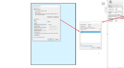

Ah! Here's your problem.  The glazing Geometry is not associated to a Material Parameter that would allow you to assign a Project Material to it. You need to Edit Family and do this:

I added a little something to my post.  All will be right as rain when you associate a Material Parameter to the glass geometry in the Family.

@barthbradley  i was able to duplicate the issue on my end using the downloaded model.
its the material in the Wicona Panel family. the glass is not mapped to the material parameter.
  • edit the Panel family
    • select the glass panels
      • in the properties, pick the box to the Right of the material
      • pick the Material option
    • reload the panel into your model.
  • from there you can change the glass material as needed.
not sure where the Glass, Clear Glazing 2 & 3 came from but they are not duplicates of the Out or the Box "Glass, Clear Glazing". Duplicate the "Glass, Clear Glazing" material and adjust as needed.

@hmunsell: We are both singing from the same hymn sheet.  See my sentence in Message #3 that starts off with "AH!...", and see Message #7 in which I emphasize what I said in Message #3.

@stephen.melhuish do what Barth said... i did pretty much the same thing and it worked fine for me too.  only difference is i didn't add the glass asset to Your material, i duplicated the existing "Glass, Clear Glazing" material.
