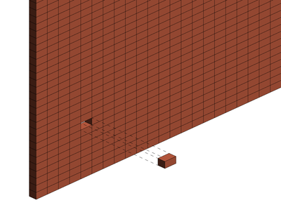

Can  we actually create a brick wall in Revit ?? Like when we will choose wall it is a brick wall that we actually create with details not a generic wall with a brick material
6 ANTWORTEN 6
Nachricht 2 von 7
als Antwort auf: bdarcel345
You mean model the individual brick units in the wall? Sure. Use a Curtain Wall.
...maybe do grout with Mullions - if you want to go there.
