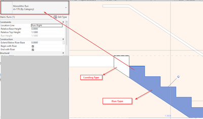

anze.kumar
als Antwort auf: MLynch1
Did you model everything with the same Run Type and Landing Type -> check if they have the same depth and properties. (see picture below)
Or maybe try modelling just with the Monolitic Run and see if the depth is OK then.
