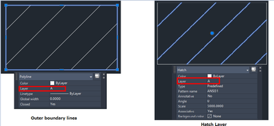

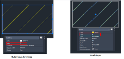

When I export drawings from Revit to DWG, I want the outer boundary lines to be on Layer A, and the inner hatch lines to be on Layer B (see Figure 1).
However, when I export from Revit to DWG, both the hatch and the boundary lines end up on the same Layer A (see Figure 2).
It seems that the hatch lines automatically inherit the layer of the outer boundary.
Is there a way to set the hatch lines and boundary lines to export to different layers?
Please guide me if possible. Thank you, everyone.

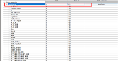

Layer A and B specification: In Revit, Layer A is defined through subcategory mapping when exporting to DWG (Figure 1), and Layer B is defined in Detail Items (Figure 2), because I think the Hatch belongs to Fill Region, which is under the Detail Items Category. I have tried changing some subcategories in Floors such as Surface Pattern and Cut Pattern, but it did not work.

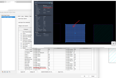

These elements belong to the Model Categories → Floors category. Currently, I am setting the hatch in Visibility/Graphics Overrides → Filter → Pattern (Figure 3).

If the surface pattern is from a material assigned to the floor, it goes to the surface pattern sub-category layer. If it comes from a filter, it goes to the overall floor category.
The other sub-categories have to do with the multi-layer behavior of the floor which is only visible in section.
This is the standard behavior for the floor exported to DWG.
