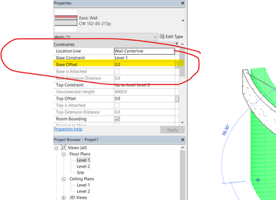

  1. Select the top wall
  2. and on the properties panel give it a Base offset to cover the floor slab
  3. Then use Join Geometry to join Wall to Floor

You select first wall then floor...not together...If that doesn't work then you might have already joined them
Join the top and lower walls to the Left too (Alternatively select all walls on the lower levels and give them a top negative offset )

How exactly do you want it to work? Many ways and thing can be done
Example:
  1. Split the bottom face of the FLoor slab
  2. Paint the split part of the floor and the bottom of the wall with brick material
An Alternative is to add a soffit
