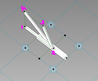

Hello everyone. I wanted to ask whether someone could tell me what is wrong with my design and how to fix it (as it does not behave appropriately I guess).
The first picture is the revit family file in which I have loaded it in to the project (metric mass) file (second picture). I created a parametric surface using the create form features, and it gives the grid perfectly until I switched the pattern to the revit family file like the first picture.
It looks like the family member does not adapt accordingly to the surface pattern, and still leaves a lot of spaces between the points. The correct version (the one that I am expecting to have) is supposed to be like the third picture.
Really hope someone could help me. I am quite new to Revit and these exercises are based on youtube tutorial videos... As for the template, I used the Metric Generic Pattern Based for creating the revit family member, and Metric Mass for creating the Parametric Truss Form. Any opinions would be highly appreciated. Thanks a lot!!
My Revit Version: Revit 2020.

If you open your truss family, flex your family by changing the pattern size. You will find that point 3 and 4 is not moving properly.
Simply create them again using the work plane of Adaptive Point 3 and 4 will fix everything.
To avoid the stacking framing, simply create the member 1 and 2 as separate elements and give them instance visibility parameter with default unchecked setting. After loading it into your mass, select the edge ones and turn them on accordingly.
The final result will be something like this:

First, flex your family. You will find there is still 1 point not following the adaptive point.
After you fix this point, load it back.
Then use your Tab key to select the single family on the edge, and check those options.
Message 17 of 18
dkevin77
Really grateful for your thorough guidance! I finally could achieve a more proper one. Although I still see on some part of the edges are not arranged smoothly, I think it is pretty adequate already.

Hi again! I think I understand my mistake now. On the file you have attached, the outer square circumference corresponds to the adaptive points, whilst for my case, the centre point of the circle (which I used to create the cylinders) was the one aligned to the adaptive points. Hence mine has so many overlapping members, which obstruct the final result.
Really thankful for your effort in providing me the corrected file. Thanks so much
