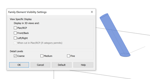

Face void is tricky because void will only cut through one surface. Even if you have cut enable, it still won't cut multiple. To over come this you have to add solid into it
Make sure you set the display to only show up in one detail level.
Load that into your project and extend that cut. Use join geometry and you should see it will join to multiple level
Switch to medium or fine detail, the solid extrusion will hide from the display
