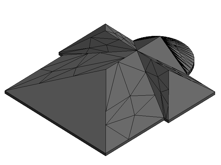

Hello!
I need to model a roof with several waters in Revit. Using the tool of selection of the edges of the roof, the ridges are not formed as designed (notice that there is the meeting of ridges in a kind of a cross). I tried to do it for parts, but there is a "break" done automatically by the software (indicated in the attached image). Could someone help me in how can I model it?

Raise your ridge height (change pitch or raised bearing wall or add heal).
Post your file. Be easier to show you.

roof slope.JPGuse Slope Arrow and consistent slope angles.

there is not an easy task - you need a fine tuning for this...
I've tried to make from a single roof by footprint but there are errors even the geometry is correct.
It works better by using two roofs joined together. The conic shaped roof was made separately.

Shape editing completely slipped my mind.
I can get there via Modify Sub Elements:
...all the ridges share the same height. 4 elevated points is all that is needed.  The rest of the points (17 of them) are on the boundary @ zero origin.

If you don't have those tools, just use the pitch angles from the roof I gave you to define your slopes.   This is the information that you need to model it as per your Roof Plan.
Or, you could find the slopes the old school way -- by drawing angled Ref. Planes from plate to ridge in Elevation View, and then measuring the angles. Either way though, you still need to determine your ridge height.  I think I used 12'-0". I have no idea if this is what you want.

I followed your steps to design a roof, just for learn (the dimensions aren't correct), but all my nearby points are automatically connected by a line, so, the shape of the roof get wrong. How can I chose the points I want to connect, or how can I delete these lines (if Revit allows me to do that)?
Picture 1) The right model you made.
Picture 2) My try.
