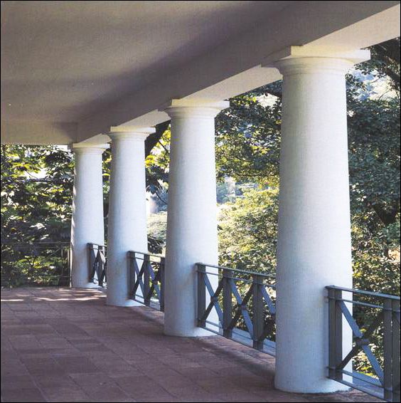

Can anybody help me? I need to model a more detailed bodyguard, because the building I'm modeling is historical, I did not find any existing families. They are made up of panels and I could only change a section considering only vertical and horizontal bars (from the photo you can see that there are diagonal bars and a circle in the center of the formed X, besides the additional vertical and horizontal bars).
I await response and thank you in advance!

You can create a baluster panel or a curtain wall panel, depending on what tool you want to use. Choose between family templates "Baluster panel" or "Curtain wall panel". Use reference planes and constrain the geometry to those planes. Give "EQ" dimensions in order to position the circle you mentioned in the middle of the panel.
