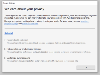

I have 2 people in the office to whom this message showed up every time they start revit.
I ended up modifying all of the .json files in this directory
C:\Users\USERNAME\AppData\Roaming\Autodesk\ADPSDK\UserConsent
and changed
"userActionRequired": true,
to
"userActionRequired": false,
Now the message doesn't show up every time, but shows up randomly, maybe 1 in 5 times... Any ideas on what else I can do?
