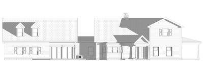

glkirk
This is what happens when importing to DWF

This is Vector without shadows
Message 12 of 14
Ah! I get you now!
Want to know what Autodesk's brilliantly stupid solution is?  Read this:
https://knowledge.autodesk.com/support/revit-products/troubleshooting/caas/sfdcarticles/sfdcarticles...
In other words: if thine eye offend thee, pluck it out.
