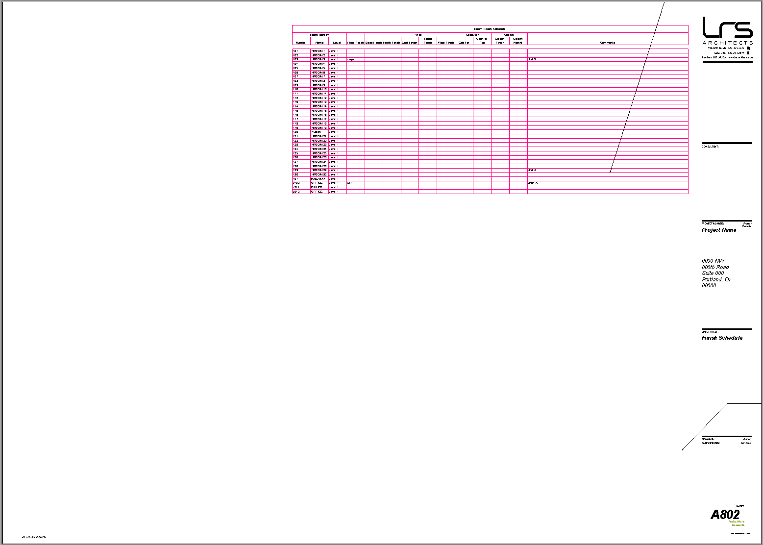

Is there a way or workaround to have Revit only print the sheet and not things that are beyond the Sheet border????
We use non plotting designer notes and we need to print sheets, but don't want Revit to look beyond the Sheet border..... All attempts at this fail.....
See Screenshot Below:

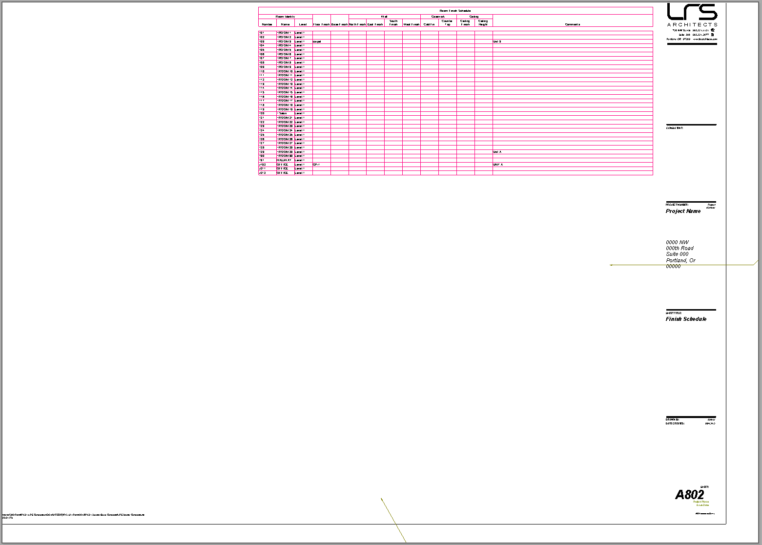

Screenshot of sheet from Revit with text added to sheet
The square marked by the two arrows is the size of target sheet (A3, 420x297)
Some text is across this frame and some right of it (third arrow).
Hereunder a screenshot of the PDF printout
Note that only text crossing the titleblock square is printed
Note that I always use zoom 100% in the print settings
So if your text is right (not left) or above (not below) this square then it should not be printed. I believe Revit starts with the bottom left corner of the titleblock as origin of the print out

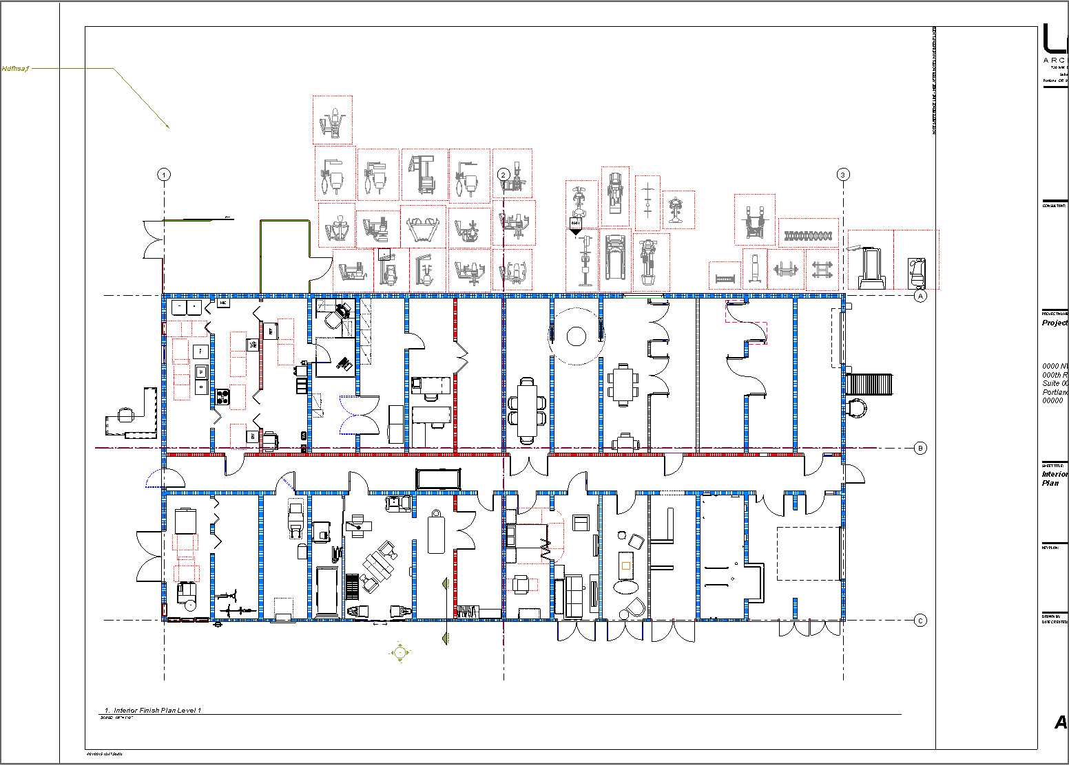

Great Comment!!!  but it does not work.....
We always use zoom 100%, so thats not the issue. The notes need to live on the sheet because I dont want PM/PA in the views possibly messing up the model. This way they can contribute, and other team memebers can leave comments without it mucking up the model.
Trying it your way:
Top and Left Notes:
Bottom and Right:
Top and Right:
Bottom and Left:
Revit still wants to shift the Printed view to include the annotations.
