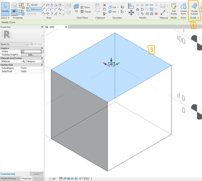

Hello, it is a great tool to select surface, divide its surface, and select pattern through these steps:
Step 1-2:
Step 3-4:
Step 5:
However, I can only divide surface and set pattern in the surface of in-place mass. Can I place it to the other surface elements? such as floor, ceiling, wall, etc.
Any answers and reccommendations would be appreciated.
Thank you

Okay, I think I understand the question. You want to know if you can divide other surfaces besides Mass surface. Right?  Well, technically no, if you mean via Divide Surface - but there are other ways to divide a surface.  It just depends on what you are ultimately trying to achieve (e.g. what the purpose of the "divided surface" is). Give me a specific example and I'll tell you how to get there.

No, you can only divide mass and generic model adaptive surfaces.  Alternately, you can export the Revit model to SAT, import it in a mass family, and divide surfaces.
