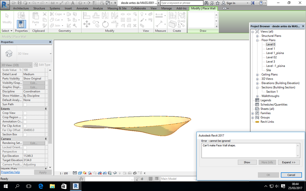

Hi! I am having this problem, where i created a mass and afterwords i wanted to apply a wall by face, but revit doesn´t allow me to do so... any ideias why? i would really appreciate the help! here goes some images to try to show you, thanks!

Create a roof by face instead.

How did you make your mass shape? Try to make it as 2 parts, left and right. then the wall face should work.

Without having the mass itself I can't be sure.. But at a glance the mass doesn't seem to have a 'Base' for the wall, that may the error Revit is throwing at you. Maybe giving the mass a hard edge for the base of the wall?

Did you want the wall to go around the Mass or over it? Confused here....

Around it!

A couple of suggestions based on my effort to duplicate your problem -
1) Using the top of the mass as a sketch, I generated a straight sided form. Top of new form = top of original mass
2) Bottom of the new form is Level 1. Created Level 2 at the top of the new form
3) Wall by Face gave me the walls very easily.
4) Wall Properties - changed the base constraint of the walls from Level 1 to Level 2.
