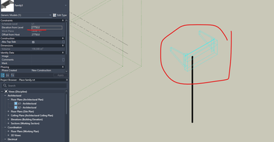

Greeting,
I want to place a abu in a column, as the image below. It works for model in place. However, it doesn't work if it is a Revit family(2nd picture). Is there any setting I could modify to achieve it? The material has been changed to concrete.
Thank you very much for your help!

use Generic Model family instead of Structural foundation.

I don't understand what you are trying to do.
This?  A negative Top Offset

Yes, that's correct.

Thank you very much. One question. Do you know what makes the setting difference between genetic and structural foundation family?
